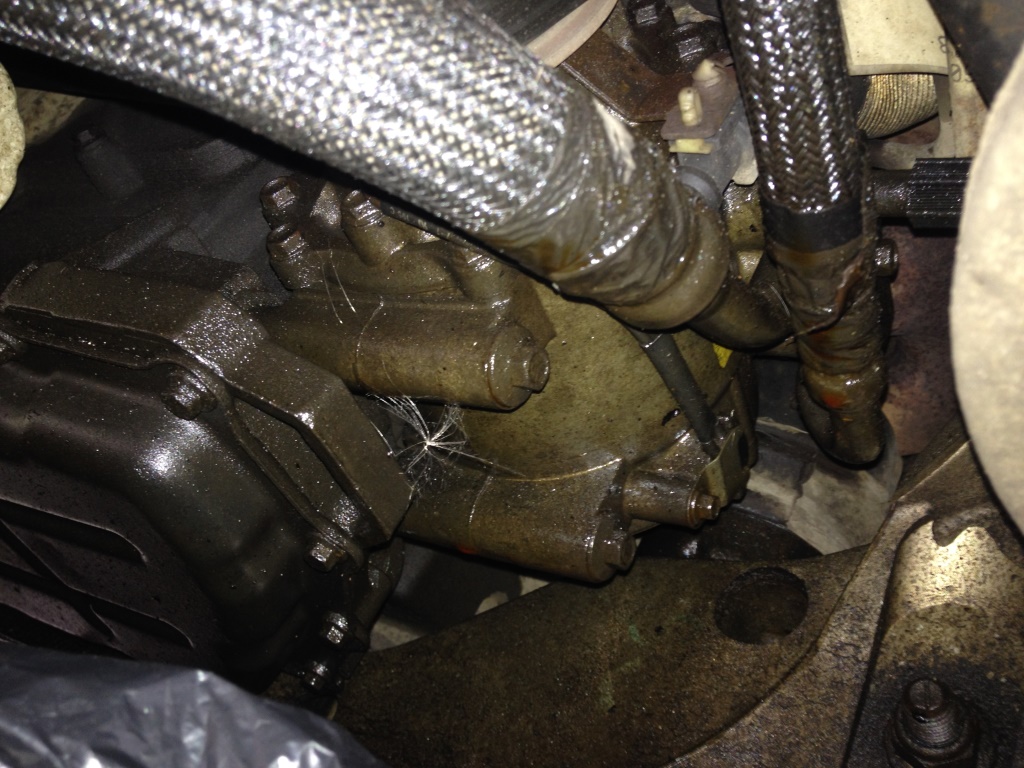

Last night, I could not go to sleep easy, so I was thinking. Climbed under the nose a little bit and realized that the leak could not come from the gearbox. Its dripping front of the front axle.
Steering fluid. Took a few pictures. Seems that the hydraulic pump was fiddle around with recently.
I hope that all it is.

If you can get it up on ramps check the unions going into the steering pump then the rack, also have a look at the pipes.
It may just need nipping up a bit, you never know.
