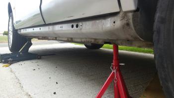

Update! Took her to a body shop today. Man said, cleanest he's seen for her age, has seen younger with worse! Photos are naff by the way, he took them for me, these guys were recommend by a jag main dealer, they also do work for another main jaguar dealer in Sevenoaks.  Three XF's out side and an Aston inside.
The rusty bit on the photos is the chassis he said not a problem only minor, but you can just about make out the actual sills, he said still silver paint Visible! On one of the other photos, you can see the sill cover at the bottom of the photo, (bright silver) and can compare to the original bodywork. In the other you can actually look through the chassis hole and see the bodywork is still clean and silver.
Happy, Happy days!!image.thumb.jpeg.97631518a5ea24e44645442image.thumb.jpeg.201440699639f2b26b4c395

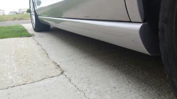

This is the sills on my last S which was a late 2002 (pictures were taken mid 2014) -

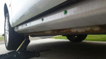

What a performance that was! So here is my recap of the things I found. Firstly when a body shop tells you "it's one of the cleanest he's seen" double check yourself!
Well about an hour and a half later the sill cover is back on (that's just the passenger side) I had to drill the recessed screws underneath (Scrivets) as they were just spinning whilst trying to unscrew, trying to pull them out with pliers just didn't work, I couldn't get a grip on them, which meant having to jack her up, to accommodate the length of the drill and bit.

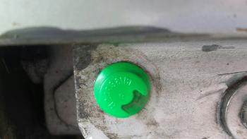

Popped off the the top of the covers gently, the green fixings (as in the photo) mostly came out from the body work with the cover, the ones that remained in the car body work, had to be destroyed to get them out.
The white fixings (for the top, to replace the green) I bought as advised by a parts supplier, are clearly different, but had no choice but to use in the end.

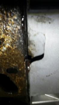

The sill does have rust, but no where near as bad as some I've seen. The photo towards the front wheel shows were the sill is crumbling, under which the green fixing. I tapped gently with my knuckle and its rotten under the paint. Anyhow I used a stiff bristled brush to remove loose debris, and gave it a liberal squirt of WD40 along the length. Absolutely didn't prepare myself for any remedial work, more fool me!

picture of the green fixing is of the part number before destroying it (H24R381B1) I think they have been superseded now, the sill cover shows very little crud gathered, which I presume is a good thing.
