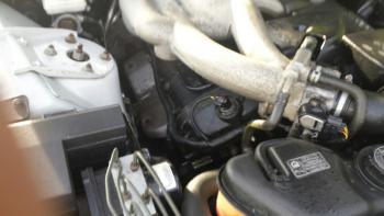

have a look at the pic taken 20 - 30 secs after managing to get to the hard shoulder of the M20, forgive finger in the pics, I was more concerned about getting rear-ended by 40 foot arctics!

looks like something let go, hose or expansion tank
can you see where its all come from

the hose from the top of the header tank connects to another piece under the air intake pipe work, I think it's called a 'T' connector? It had sheared off! I believe I got her to the hard shoulder before the temperature gauge hit red, I drive in a 'business ' like manner so getting her to a halt as quick as I could took a good few seconds. The temp gauge was sitting in the middle, when I first noticed the red warning light and coolant low message, it climbed quite dramatically I've got to say.
