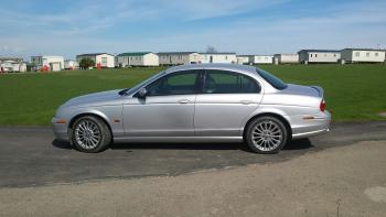

A 2nd s-type diesel appeared near me today. An 07 plate with 104k on the clock. My girlfriend's dad kindly helped me inspect it over and it drives beautifully, like many of you said the diesel would. The garage said they will do the cambelt change and service which it's now due and I'll be picking it up next week!
  • Like 2
Very nice car:thumbsup:
make sure urge you read and understand the section of the handbook that refers to the pdf regen cycle.
bradon a nice looking purchase, hope it puts a smile on your face every time, please what is the colour i just love it. anything you may consider changing or upgrading ?
