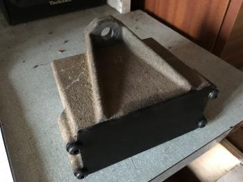

If it’s anything like the 2.2 the rear diff has a noise damper on it which was a service bulletin to remove if the customer experienced an issue at low revs. It’s one bolt a five minutes to remove. See below.
