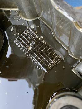

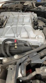

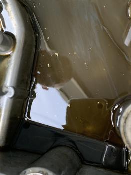

Anyway back to the car, attached is a clip of the engine running for the last time before working on her. Tonight I dropped the sump and found pieces of metal, suspect the remnants of a spun bearing. Confirms the full engine out rebuild. Next is to remove the exhaust, bonnet, front bumper and the wheels (bought a second jack so I could jack the front up evenly and safely on the ramp. Plan is to drop the engine and gearbox from underneath.

SteveIMG_0299(2).thumb.jpg.c086b2f575a935ca8f3793015672dfbc.jpgIMG_0300(2).thumb.jpg.94a610af7c85faa57d51a77bbc9d754b.jpg0109e86d948ab2c3660b17c20f9d2dd7c19d54986d.thumb.jpg.ffbc25cbb3c60cbe6e00c8e9bccce9e9.jpg
