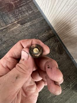

Hello guys! I did this today and tried to open a rusty bolt and the bolt and top of the positive connector broke! I can fasten the connection again but when i do and try ro re assembly my jaguar wont start at all. Also i get red brake light flashing along with abs fault etc!! Can i do anything at all to fix this problem? Thank you so much in advance! This frustrates the hell out of me!
