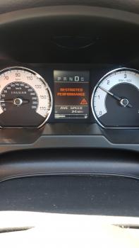

So I've recently purchased an 08 2.7 litre luxury automatic diesle XF on 110,000.
Everything has been going great until today. When I pull up to traffic lights or stop with the car I'm experiencing juddering, inconsistent revs (even though my foot is on the brake and not on the accelerator) and the car seems like she is struggling, spluttering and almost stalling.
I have a video of when I'm parked on the drive and you can kind of make out the juddering if you compare the steering wheel to the background. Excuse my little lad in the background he just really wanted to get out the car and the poor quality but I just dont know how else to portray the issue.
Now my car is showing up with restricted performance on the dash too.
It feels like the car is struggling to remain consistent when idling eithing parked up, at traffic lights ect ect
Any help of advice will be really helpful.

So update...
Plugged the car in and no codes were found. Which is strange because it was in restricted performance mode. Might be the brick I used (although I did try 2)
Anyway the garage I brought the car from has said that I'm still covered by their warranty and as I'm within the 30 days of the purchase of the vehicle I am also still covered under my consumer rights to return the car too.
The car is currently back with the garage I bought it from and its getting the once over to find out the problem. I'll keep you all updated with that they come back with as I will need advice on whether you guys think its correct or not.
Hopefully it's nothing too serious and its just an air leak or something easy to fix
So I've got an update from the garage I bought the car from...
Apparently the problem was caused by a blocked DPF?
They've done a forced Regen on the car and now it's working fine. I've not seen the car yet or any receipts for the work done ect so when I pick it up I will be taking it to another garage for clarification.
Just wanted to pick everyones brains as to whether you think a DPF would cause the car to stutter like this?
