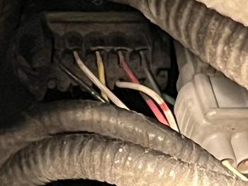

Hello, I have the 1997 XK8. I, too, am facing this issue. I realize your post is 2yrs. old, but thought I'd share with you my experience. Reaching down and following the cable with my hand, I managed to locate it to a harness behind the throttle body, near the firewall. It has seven wires, and my harness is pictured in the attachment. I have also attached a photo of the neighboring three harnesses which are a bit higher up and easier to see, but the one that goes to the rotary switch is the black one.
