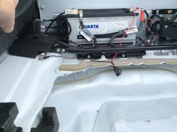

Always better to use the ground point David, here’s mine4701D85A-FE38-457B-B28E-C6D3CF928AC6.thumb.jpeg.db36b89da83c21a45d087b0348bd26d1.jpeg
As you can see I have used the main negative ground of the battery so as not to bypass the BMS.
