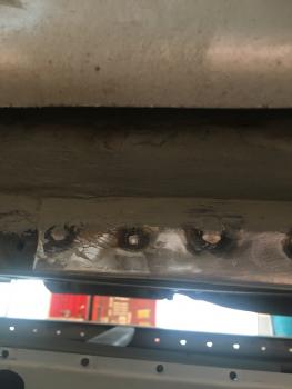

The first shows a very small part of the complete inner sill which had to be fabricated from scratch.

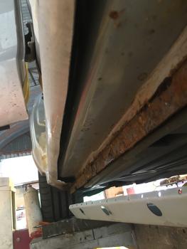

The second shows the outer sill cut back to remove all the rot and shows the initial state of the inner sill.

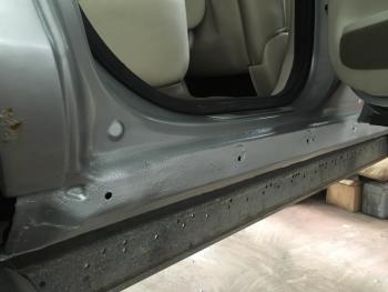

The third shows how the outer sill was shaped to fit. Disregard the surface rust which will very soon not be there either!
The fourth picture shows the outer sill in place complete with Stonechip rubberised armour.
